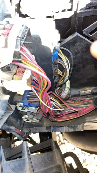

i thinkj i have found the issue i have a cut wire i have a few wires that are freyed into right under the fuse box but only one completly cut off im guessing that is the culprit i will post a pic here soon might need some help with wiring also looks like something started to get in there at some point its seems minor but im not no electrician

IMG_0003.jpegIMG_0004.jpegThis is my issue the wire that I stripped I hooked up and they turned on but it’s to short for me to tape up and trust so what gauge wire is this and can I just cut me a putt piece and throw in there with two butt connector heat shrinks and be worry free or is there any way I can replace the wire from the terminal and just have to have one heat shrink butt connect in there

And don't be me; about 9 times out of 10 I remember to put the heat shrink on the wire before I solder it. It's that tenth time that drives me crazy.
Glad you found the issue.

The best fix is to solder in a piece of wire with heat shrink on it. Wire size, as long as it appears to be close to original is not too critical given the short distance. It's probably 14 gauge I would guess.
yea i got it all hooked up this morning with some heat shrinks and now they work gonna see if its all cleanly connected tonight and make sure they dont flicker while driving... thank you everybody
