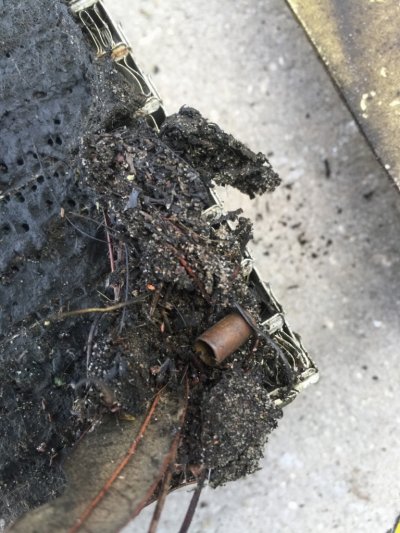

So I got a 04 4x4 1500 with the 5.7 Hemi and found I needed to replace the Evap coil due to it leaking. I pulled the dash out and got the heater core out. When I cracked open and pulled the Evap coil out holy cow what I found was crazy. Completely clogged up and even found a .22 shell casing.....definitely was a leak. I will be getting it charged and hope there are no more issues and I have ice cold a/c! Here are some pics of the coil LoL!
