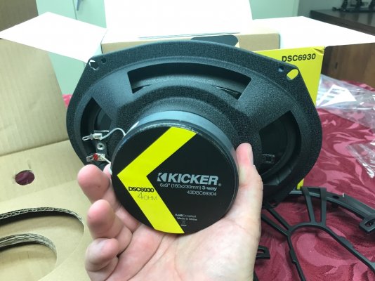

Finished this project up tonight, no pics of the dash speakers though. And wow what a difference in power and sound quality even without an amp. The stock speakers were a joke, tiny magnets, paper cones etc. This is probably the best $150 I've spent on my truck in the last two years of owning it.

So despite Crutchfield stating the speakers do not fit my 2014 Ram 1500 Crew due to depth in the front, no issues with the window?
They touch a cross member inside the door, but don't affect the window or rattle or anything. If you watch the video I posted on the original post it explains that. [emoji1303]

The ones I bought are fairly shallow, they touch a metal bar in the front but no other problems or interference.
I'm the same way, I'll buy all one brand.
I can't answer as to what will fit and what won't fit but I do know these can be made to work fairly easily. I'm sure if you look up the specs on the speakers it will list the depth of them.

I would suggest putting some type of rubber between the speaker magnet and that metal door piece. Just something to absorb any vibrations so that you don't wind up with buzzing at higher volumes.
