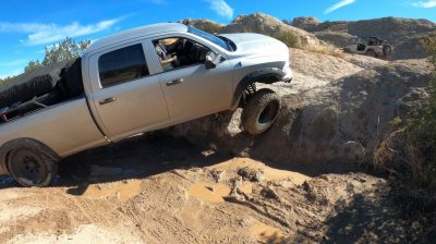

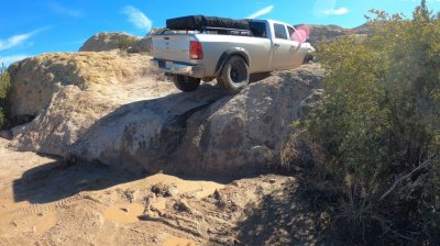

Wrong. Putting in the standard 2500 coils will hinder articulation, as they are much stiffer. Bags do not hinder it at all, as long as you go with a bag like the airlift with internal bumpstop, which can be run at 0psi.
If you tow a lot and dont off road much, then the regular coils and a spacer would most likely be an improvement for your usage. This is what AEV recommends when using their kit. However, offroad articulation is definitely worse than the stock setup.
Most aftermarket lift coils will be much softer than a regular 2500 coil. However, most are probably close to what the power wagon is. From my understanding, carli’s coil may be a bit stiffer than the stock power wagon coil.

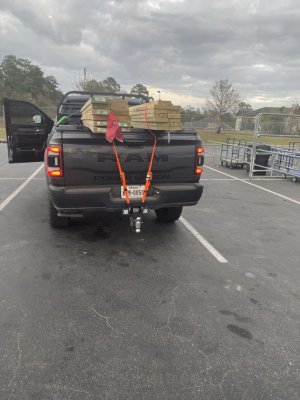

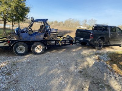

I think bags are the way to go for towing or hauling. @olyelr did a nice write up on air bags. Remember that the payload police will get you if you over load past your sticker regardless of your mods. Definitely get E rated tires if you are going either route, the stock tire will wear out quick on a constant load. I have 15k with mixed driving and I might get 25k and I tow every 2 weeks and haul at least once per week.

I have seen pics and information on a stock power wagon vs aev suspended power wagon vs thuren suspended power wagon at moab. AEV didnt amount to much. All it is is a stock ram 2500 suspension setup with spacers to make it higher. Great for towing and working... ****** for wheeling.

I have the daystar cradles. No limit at all with droop. Had them several years now. Never had a single issue.
Doesn’t **** with ride quality at all, either. They are completely empty unless I am towing.
