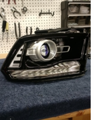

Hey guys, I'm thinking about retrofitting my headlights myself. Never done this b4 so I had some questions, if u could either answer them or point me to the right direction that would b awesome. I'll try and post a pic of what I wanted to do to them to.
I have a 2017 ram 1500 with the projector headlights and Ive got a hid kit put in.
I wanted to add rgb halos, and clear corners instead of the Amber ones, and im thinking about going switchback led boards.
They r already black and I wanted to paint all the inside stuff white.
I also have a headlight shop taking the clear part off the headlight for me and revealing them for 300. He quoted me 1040 just to do the halos so that's y I'm thinking of trying to do it myself.
I was wondering if anyones ever done this b4 how hard was it?
Was it hard to wire all the stuff?
What brands did u use?
What kind of paint did u use for the headlights?
Did u have any problems?
Would you recommend anything? Or tips?
ThanksView attachment 149014
