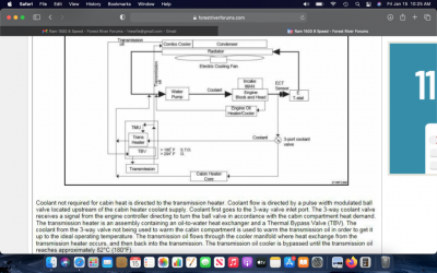

How about doing something as simple as placing a valve downstream of the 3 way Engine coolant valve? Between the valve and the transmission TCU. Something like a small ball valve.
This would stop hot engine coolant from reaching the TCU on the transmission. That together with the removal of the bypass mechanism in the TCU would seem to get optimal cooling. Hell, if you operated in extreme cold weather you would have the option to open the valve and let Engine coolant flow on through. Best of both worlds. Isn't that essentially what the blocking plate from RevMax is doing? You would still have Engine coolant to the cabin heater. The valve would receive it's instructions when to open and close, and would follow those commands. Just that no Engine coolant would flow to the TCU on the transmission. Seems too simple , I know. But why not?
So far i haven't found anybody who's running it just with the thermostat bypass in place,with the thermal heater unit still active.
The couple guys who are running the kit,are utilizing the plate,and reporting tranny temps in the 140'ish range.Before i get too worried about deleting the coolant flow to the thermal unit,i'm going to run it still hooked up,and see what happens with the temp and how long it takes the transmission to warm up. If it still seems too warm to me,i have a couple ideas to try. One is just disconnect the heater hoses to the thermal unit and tie them together,the other is very similiar to your idea,but use an old style cable operated heater control valve,and run it inside the interior ,so you can operate it from inside,and while going down the road.Your idea is good also with a manual ball valve under the hood.But till i actually see how things pan out with just the thermostat bypass,which won't be for awhile yet,i'm not going to worry to much about it,lol.My idea is to use something like this .

you also mentioned at some time placing a clamp across the lines as a temporary experiment. this would accomplish the same a placing a valve in the line. I was just thinking that it would be an easy process to place a valve in the line close to the 3 way diverting valve. It is pretty accessible.
I am anxiously awaiting the results from those of you who have removed the bypass plunger and spring in the TCU.
I'm still going to see how it works first with just the bypass,if it's still to warm,i'll first try my idea of just using hose pinching clamps to restrict the flow to the thermal unit,if they work,then i'll spend the money to do it with a manual cable operated shut off valve,lol.I'm hoping CrazyKid gets his out for a drive this week-end and can give us an update on how the kit works with just the thermostat bypass in place. My trucks still parked for another couple months at least,it won't be coming back out,till the snow is gone and the salt is off the roads,i hate Canuck winters,lol
