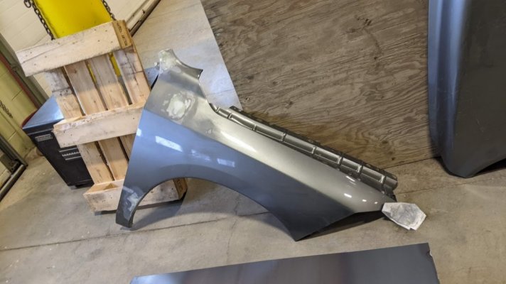

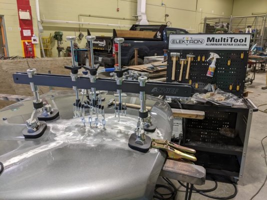

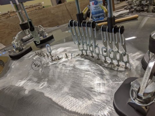

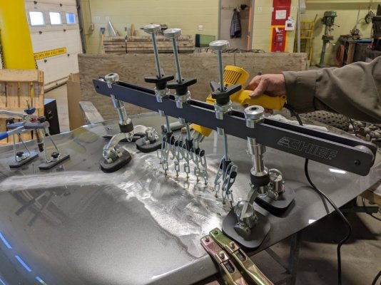

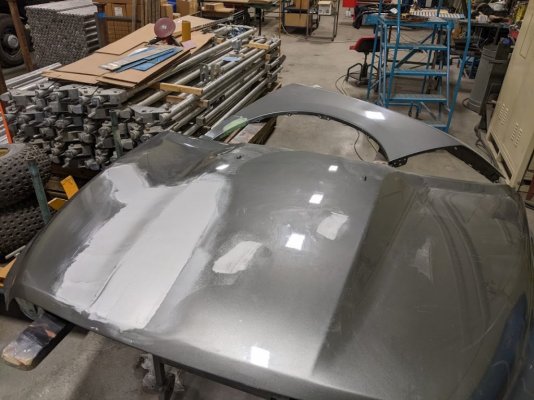

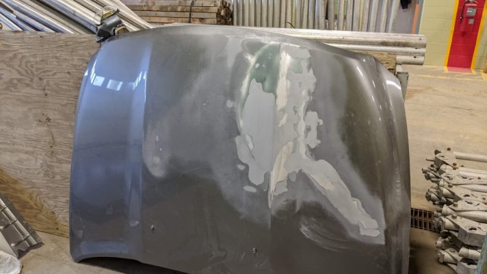

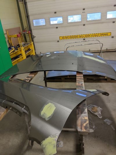

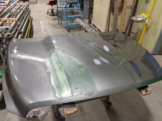

Well I finally started prepping my truck for this Rhino liner job im doing in the spring.
I use my truck for Hunting / Off-roading and after 10y I think its time to give the paint some attention.
This will also allow me to Fluid film my truck at the same time since im taking the Box , doors and fenders off to do this job.
Should be able to get by with 4 kits. ( fingers crossed )
Used 3M short strand fiberglass filler ( Green stuff ) for the first time. what an amazing product, as well as the steel finish putty. Expensive but holy hell does it ever work good.
Deleted the stupid antenna as well. Ive ripped it off pretty much every hunting season... lol...

Was able to get more done today. Hopefully Ill be able to prime it tommorow.
