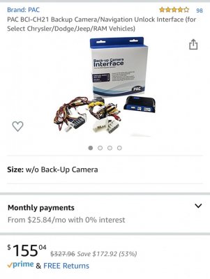

The radio does nothing at all. Looking at the radio menu, the camera settings do not appear, although I can only guess where they should be. I checked Appcar and the reverse camera is enabled, so apparently there is still an issue. The donor vehicle was a Longhorn, so I find it strange there wasn’t a camera on that vehicle.
I ordered the PAC BCI-CH21 from Amazon, hoping this will solve the mystery issue. At this point, I’ve spent way too much time on something that would be simple with an aftermarket radio.

It did. Like a charm. The instructions aren’t perfect, but fairly easy to figure out. Program the module from a computer, then install with the pass through harnesses provided. I could have saved a lot of time just going this route.
