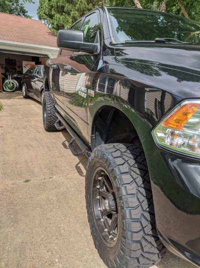

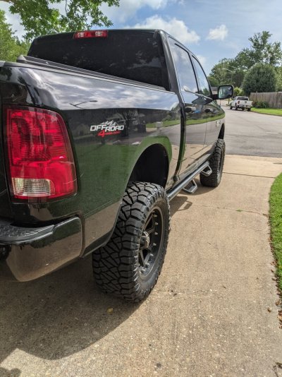

I got my rig about 4 years ago new to me. It's a 2013 1500 Express 4wd. Previous owner added a 6 inch Pro Comp lift and 35 12.50 20 nitro ridge grapplers with XD wheels (not sure of the wheel specs).
Lately I had been having some issues with my steering which led to some much needed upgrading to the underneath.
New:
•cv axles
•inner and outer tie rod ends
•upper and lower ball joints
•intermediate steering shaft u joint
•sway bar end links and bushings.
•steering rack (stupid EPS)
•Fox shocks all around. Performance Series 2.0 Coil overs up front - Performance Series 2.0 Smooth Body IFP shocks in the rear
•Nitto Ridge Grapplers - 35x12.50x20
•black Gorilla lug nuts (because one of them broke off while replacing the tires and found out they were the incorrect size)
Fast forward to today ... after some waiting on the parts to ship ... and a couple of hiccups with the install. This thing rides like a freakin' dream! I never want to get out. I now take the long way everywhere I go
Now all I need to do is keep it clean!
