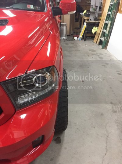

Aren't stock sport wheels 20x9 with like +18 offset? Here is my old truck 12 sport with 20x10 -24 offset. With 33x12.50 tires. 2750ebb0d29e37da37e8f789514785b1.jpg

Stuck out about an inch or a touch more.

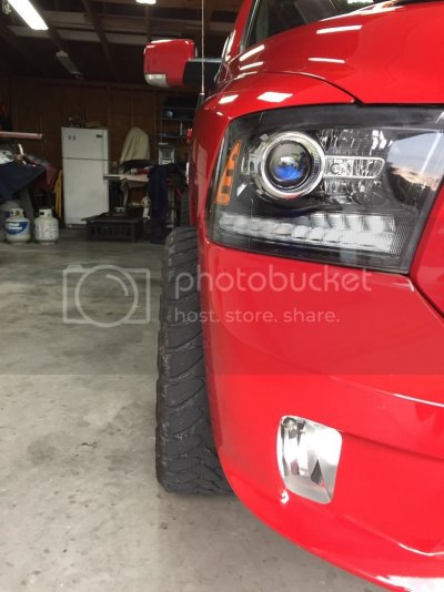

here is mine with 20x10 -24 mm offset and 33x12.5x20 tires and they definitely stick out further than an inch....the tire is close to 3" out
here is a shot with fender flares which give 1.5" of coverage roughly

That's perfect leveled or factory front height? Any rubbing?

Bilstein 5100 adjustables set at 2.1 with no rubbing. There was rubbing before I installed the bilsteins

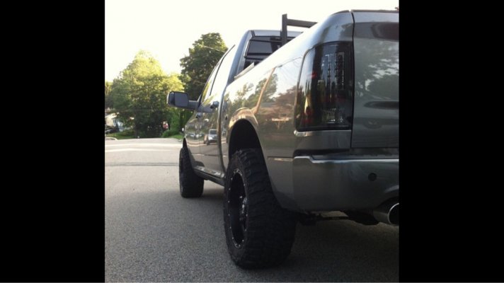

20x10 -24 but I have maxtrac spindle pushes it out an inch
