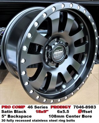

(Un?)fortunately, they are not misleading you. 17” wheels (and, in fact, a pretty decent number of 18” ones too) do not fit over the brakes on our trucks.

As Jake mentioned it does seem 5th gens need at least an 18". Unless you have a 2019 classic (4th gen) rather than the new body style(5th).
