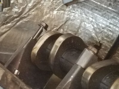

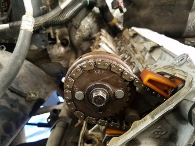

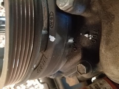

So I was able to get back at it today in to 110 Phoenix heat. I found a couple of things:
1. The last bearing cap on the camshaft (driver next to firewall) is broken. Half of it was down between the valve springs where I found the rocker arms.
2. I cannot get the timing to line up:
* When the V8's are at 12 o'clock the TDC mark is about 3 to 5 degrees off
* There are no plated links on the timing chain. I've looked and clean both
chains and nothing... (see pictures)
So my questions are:
1. Is it possible that all of the problems are related to the missing cover? If I just replace that and get the 3 rocker arms that were out of place in place, all will be fine? (I know unlikely...but I have to ask :))
2. If I do have to align the timing to take off the heads, how do I figure out the difference with the cam sprockets and the TDC mark...especially with no plated links to help???
I'm attaching pictures of both cam sprockets, the TDC alignment with the V8 on the sprockets and 12 o'clock, and the busted bearing cap.
Any insight is appreciated!!

When I read your first post I was thinking that if the rocker arms came off the engine would lose power and act as if the head gasket was blown. Before going any further I'd check to see what the oil in the pan looks like. As far as the timing goes those marks should line up when the engine is assembled but once it runs the marks and links will move all around, I'm sure you've got some bluish looking links hiding somewhere down by the crankshaft. I'm not a mechanic and I've never worked on a 4.7L but unless you think the timing chain got loose enough to jump a link or two, assuming the oil in the pan looks good I'd just replace the parts on the valvetrain and see if it runs.

RonJon,
What am I missing here. Why would timing marks jump around? Isn't that the entire point of the timing system/chains...to keep piston and valve movements perfectly timed with each other (especially on an interference engine?)

Yes, but once the timing chain is installed the dots on the sprokets won't line up with the marked links each and every revolution. Those marks are only used to make sure the crank and cam shafts are in the correct position when installing the timing chain.

Might need to start thinking about what caused the cam shaft end cap to break. Maybe the timing jumped and caused some of the damage?
Sent from my SAMSUNG-SM-G890A using Tapatalk
Jerseystyle,
Thanks! I was wondering if the offset timing marks and the broken bearing cap could be related. I figured the head would have to come off :(
Here is my big question... Every manual and site I look at describes aligning all of the timing before removing the heads. What if you can't do that like in my case? Do I just take it all off and align the timing when I put it back together? If so, how do you align timing at that point? I have a guess...but with timing on an interference engine...I really don't want to be guessing :)

I'm no expert, but I'd say get it to as close to TDC as possible. If it's just slightly off during head removal, I honestly don't think it'll have an effect. I'd be more concerned with what other worms you're going to find. Bearing end caps don't just break.

The Plan
OK...I'm out of town this weekend...so next weekend here is my plan...if this is missing anything...please let me know :)
1. Set TDC using balancer & timing cover markings (cam sprockets will be slightly off)
2. Remove heads per manual (Haynes) with far less care trying to zip tie chains to keep them in place since timing is probably off.
3. Evaluate what I see...post pictures here...pray!
4. Worry about setting timing on reassembly if I ever get that far.

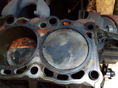

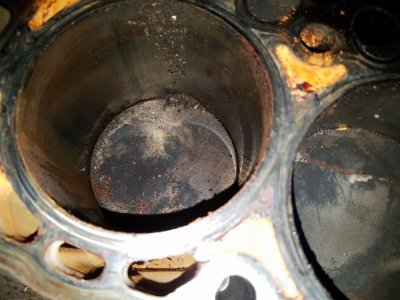

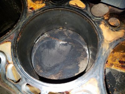

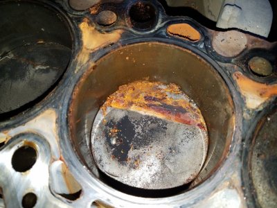

Got the Left head off yesterday. This was the more concerning side and harder to get to with the head bolts under the brake booster. A few more details came to light:
- Actually both of the back two cam bearing caps were busted and there is a crack in the 3rd.
- Also we found another rocker arm...something must be wrong with my math because now I think we are up to +1 rocker arm...yep, going with bad math.
- The left secondary timing chain did have plated links, but the chain had been installed backwards.
- the best news of all...no holes in the pistons!
- there is no obvious, catastrophic failure of the head gasket, but there is a bit of shared white residue between 1 and 3 on the head and a rusty good in #3.
I'm including pics of all left cylinders and valves below before cleaning, if anyone notices anything i should be aware of (my first time...)...(note the small divot on the right side of piston #1 is just a lighting thing...there is no divot...)
thanks!!!

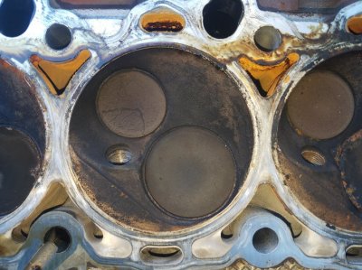

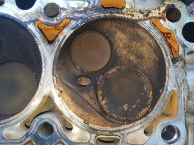

Here are the valve pics...
