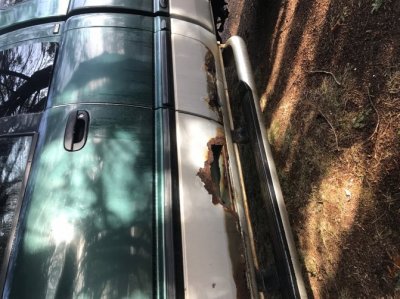

My truck has some door rot, all 4 doors. I see those chrome covers they make, does it cover a lot of the door? I need to cover this size hole, can't afford spending 1000 on doors since clean quad cab doors cost a metric ton.

Do you have access to a welder? Mig or stick preferably. They make covers for the lower door panels, but if you cant find some big enough, you can buy sheets of thin steel and make your own.
These aren't too hard to do the outside, just bend a curve into it, for the inside you can use aluminum or something else, but it wont matter as no one will see it.
Thats the cheap way.
Another option is to goto a junkyard with a grinder, find some pretty clean doors and grind the parts you want off, that way you're paying for sheet metal, not the whole door.

Yeah you can prob cover most of it with those but it'll get worse quicker
Found these, think they'd be cool. thinking that if i spray the rust with inhibitor or whatever works to stop it's stressing these days I'll have a good shot at hiding the damage and making it look good. Have to measure it up and hope it works. Spray them black if it works and the truck will look beautiful for a while. https://www.realtruck.com/willmore-diamond-plate-rocker-panels/R183932P1999Y790MA.html
