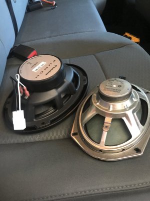

Man...are we sure these can fit into the front doors on a 2015? I'm in the middle of the install...rain delayed...but I don't see how those are going to fit. Even if I can get a screw in, I won't be able to get ALL of the screws in. I wonder if they changed anything from 2013/2014 to 2015?
On the rear doors, the kickers worked...not all the mounting holes line up though. I was able to get 2 screws in opposing corners. They're tight...I'll probably be ok without the other 2 screws right?
Just frustrating when Crutchfield says they'll fit.

I just put in some Hifonics 6x9's in front and rear doors. I used 6mm spacers in the front and rear doors because the metal basket/frame of the speakers are larger around than the OEM 6x9's.
I started the screws one at a time to make sure they were started in the holes and then tightened them down cross wise from each other until they're flush.
