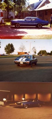

Question: What would be your ideal first car as a just starting out 21 year old driver with limited 4-speed experience ?
Answer: 1972 Chevrolet Chevelle SS, 454 LS5, 4-speed Muncie M-22 Rock Crusher, 3.73 Posi.
Bought that car and never had two nickels to rub together afterward, but holy ***** them were some good times.
