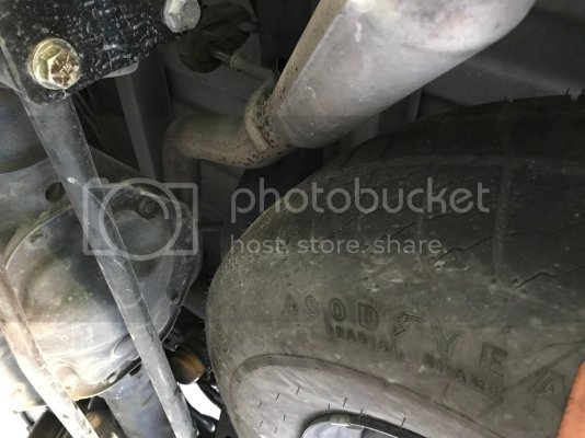

And they said it couldn't be done....... well I did it and kept the factory duals
This is my prototype. I had some 4x4 square tubing with 1/4" wall. I will actually be using 2x4x.25 tubing to build the final product

Nice job. I plan to do something similar. Recieved my Street Scene roll pan a couple days ago. Not sure if I like it yet. Seems too flexible to maintain it shape well. Which roll pan do u have ? Do u plan to have a reciever hitch? Any pics of yours finished ? Any advice ? Thanks.

That is the receiver hitch I built
