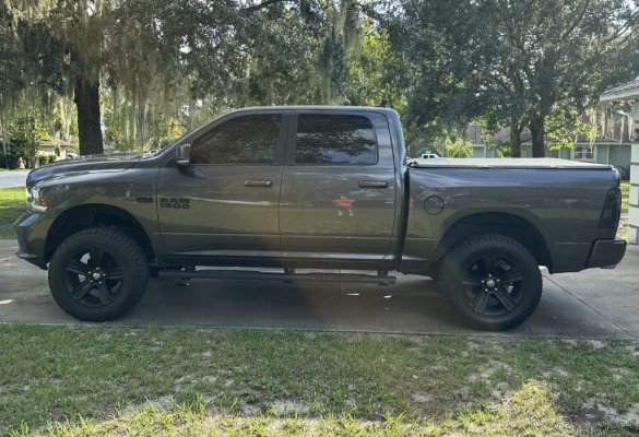

Good am I had a 4 inch RC suspension lift installed but the front sat 2 inches lower vs the back, had new spring's installed in the front with the front now 1 inch higher which I'm fine with question is are there any safety concerns and what options do I have to raise the back end up an inch?

Your headlights are most likely blinding people with the front sitting higher. Also if you tow or load weight into the bed it may feel very bouncy or floaty in the front

Thank you I normally don't tow anything, I was curious why springs took the front end up higher then what they marketed for (2 inches only)
