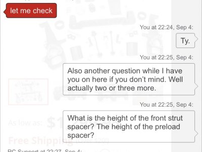

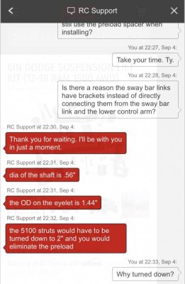

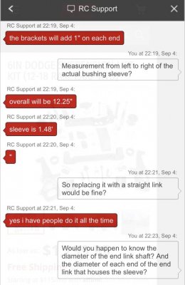

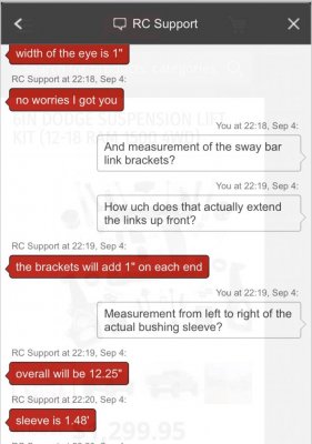

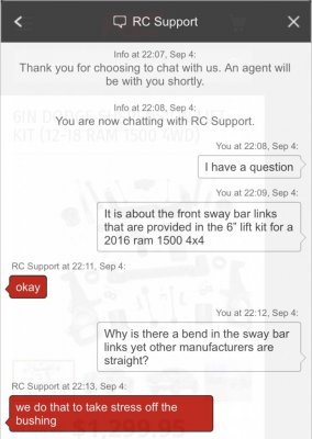

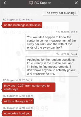

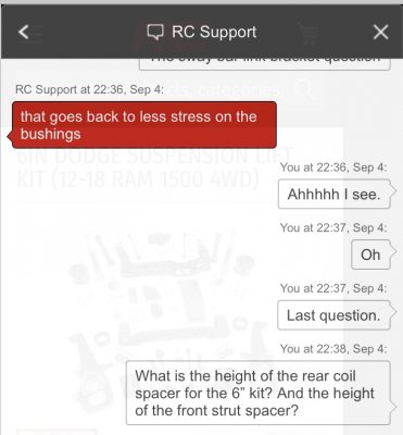

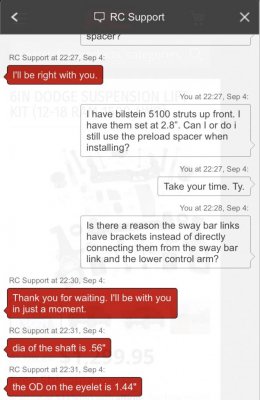

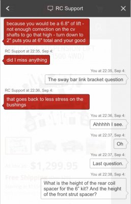

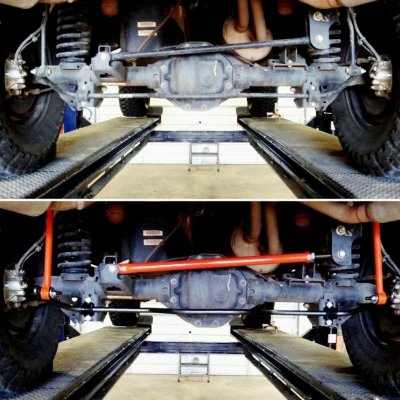

1877D76E-586E-46D2-A0A9-0C3E67F3D292.jpeg So I am currently overseas and needed to get some specs on a RC 6” lift I have on my truck. 2016 Ram 1500 4x4 Crewcab Tradesman. Granted I’ve changed most of the components out so far with beefier components already. Just wanted to post the conversation I had with RC customer service that answered front and rear sway bar link measurements and spacer measurements. So this is for anyone who happens to need the measurements and like me were to afraid to ask at first.

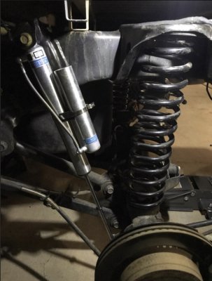

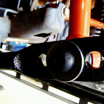

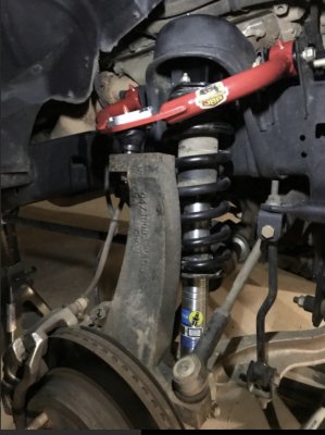

If anyone has any suggestions on how to eliminate the coil spacers with replacement struts or rear replacement coils, I am all ears. Ty. Here are some replacement parts I’ve already put on. BDS rear coils, bilsteins 5100 and 5160, JBA UCAs, Bwoody Performance adjustable track bar, Bwoody Performance custom length rear sway bar links, and Hellwig rear sway bar. Also have Core 4x4 rear UCAs and LCAs but have not had chance to install and also waiting for the Pro Comp rear UCA/LCA relocation brackets. Any suggestions, critiques, complaints, and gripes are always welcome.
