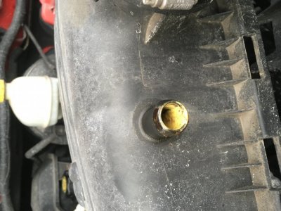

Ok I changed the oil on last Tuesday and everything was went great until Saturday morning. I turned on a road and it just quit. When I tried to restart it, it acted like the battery was dying. On the 4th time, it started but had a very rough idle and struggled to stay running. Now, when I cold start it it's ok but a light shake, like a small misfire. As soon as I touch the gas, on idle, it turns to a very rough idle and struggles to stay running. I have checked the sensor, vac lines, fluid levels, air filter. The picture is the tube from oil fill to air box connection. Any ideas?

How much oil did you put in it? What is that yellow gunk in the breather hose outlet?

I put 7qts in, as I always do. And I have no idea what that gunk is.

That yellow cheese looks like a water/oil emulsion. How did the oil look when you drained it? What does your coolant look like?

The oil was old, normal. No discoloration. The colant is normal. A friend hooked up a scanner and everything came back pretty normal. The only thing that was interesting was the intermittent oil pressure. We also found out that it won't idle but runs fine at a higher RPM.
