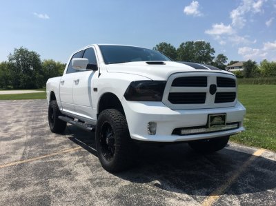

i have a 2016 ram 1500 with 33' TOYO RT on 20x12 rims. I love the look and everything about my setup... when i initially got these tires i had beads in there and the ride was awful i literally would hit a bump in the highway and bounce halfway across my lane. i got them rebalanced with weights and adjust the tire pressure to around 35 psi and the ride has gotten much better. However, fast forward like 10k miles (2 tire rotations) and my ride is pretty rough again. If i hit a bump on the highway i can feel my truck jump around. Even going straight a bump in the road can jostle the truck pretty good. I have 31k miles on the truck and from what i can tell its stock suspension.
so my question is this... i really need to soften my ride up and get a more forgiven suspension. Will bilsteins help? or is there other shocks out there that may help? what is everyone running with bigger and heavier tires? I wouldnt mind getting bilsteins and getting a little bit of lift out of it also... but i want to make sure that it will help with the rough ride

I run the Bilsteins I have a 4 inch lift with 35's and love how it handles and rides. I still run stock shocks in the back with 3 inch coil's. People cannot believe it rides as good as it does for being lifted.
