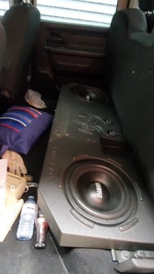

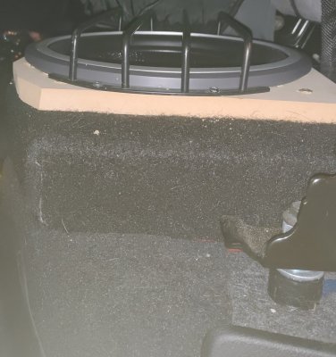

There's a good amount of room once seats lifted. Here is a few photos of mine, have 2 infinity 1200w subs. Box fiberglass, been running this setup(box) for around 2 years. I checked the lift for you and was just under 2 inches, may vary by vehicle. You can see in photo how large box is and fits perfect. Airspace is combined, right at 2 cf total. The infinity 1200w needs right around 1cf per sub. I wasn't going to get infinity subs, was going to do a single 12 and use all 2cf, but amazon had those infinity's for $85 last year, I ended up buying 4, still have 2 for another car. They say 500 watts rms each sub, but I'm running just over 1,500 watts @ 1 ohm rms and held up for over year playing at high volumes and deep bass.
Right on buddy, the box I have now a foxbox, is 1.55 cf per sub ported, I'm running 2 sundown 500 RMS each, it pounds, I just want more, you can buy seat spacers off net audio they are 1.5", yours looks like it may be a bit more though , or right close to there, I'll have to check when I do it, I'll use the spacers and add washers and see how it works

I did measure mine, was just 1/16th less than 2 inches. I'm running a SoundQubed that they dyno tested on youtube that put out over 1,500 watts rms, but being sealed box, is more a sound quality setup, would probably rattle my teeth loose if ported. I got the fiberglass box basically for free on here, member who made it, basically gave it away if I paid shipping. Think was $15 plus shipping.
