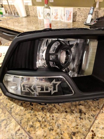

Really like the look of these shrouds. Also etched "RAM" into turn signal lens. Was thinking of etching the projector lens but might just keep it plain on this build, not sure anything would work with the "RAM".4f97014c201b0d1787ce54e99a523952.jpg154bad23217621443a119780d8826161.jpg

Like the etching. How do you do that?
I use the airbrush or "air eraser" if u looking it up. It uses compound to etch. Like a sandblaster just on a really small scale. My wife has a plotter so I can make my own stencils out of vinyl.

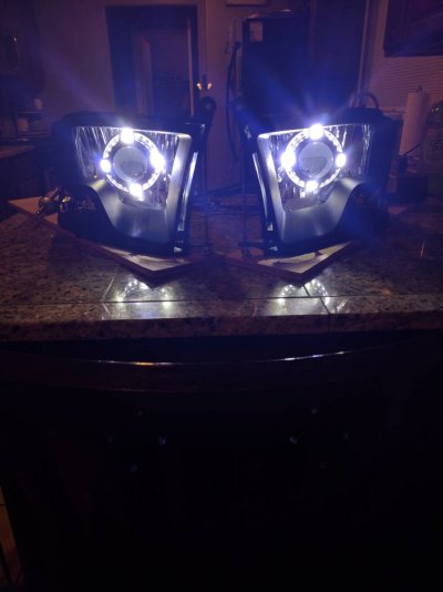

Got them sealed up and mounted on the truck. Love the look the duals have with a projector in them. Everything works great except the H13 adapter I got doesn't snap in so just had to zip tie them together. The etched "RAM" looks great, very subtle with no light and pops with lights.e2e024a33b091778a8601672b8e39c06.jpg31648241717709349b16e74bd0b24586.jpg

Really like the turbine. The chasing halo is a nice touch.
Sent from my Pixel using Tapatalk
They could do much more colors and combinations of course. The halos I used we’re cheap too, the controller was picky

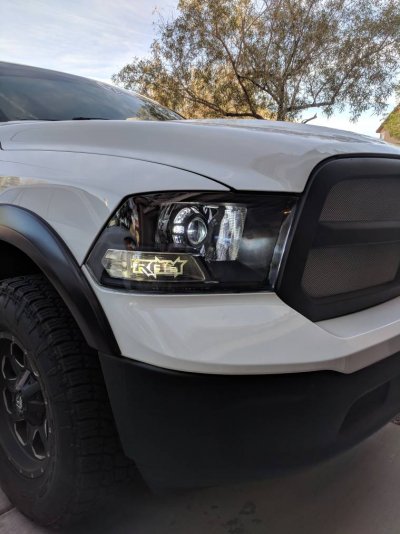

Here is a front end shot. I love the simplicity and look of these lights but I have so many more ideas in my head for more dual headlights that I will probably be putting these up for sell in a week or two. My next set I might go a little overboard with demon eyes, halos,more custom etching, and maybe a theme(sports team, military, super hero/villian).4b9fe5b93c304b072fa5182bcfd1fe1a.jpg

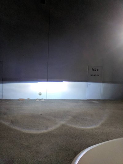

Finally got a output pic. Driverside hotspot is off a little but there cheap hid bulbs for testing. Cutoff line was a little tricking to get aligned for some reason this time. d6c196b3162c9e3c5c1e05d6b7f8c12c.jpg
