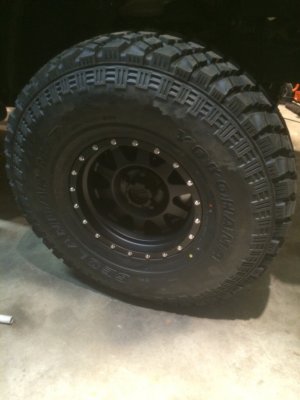

40x13.5x17 Yokohama geolander mt plus on 17x9 -12 offset method standards

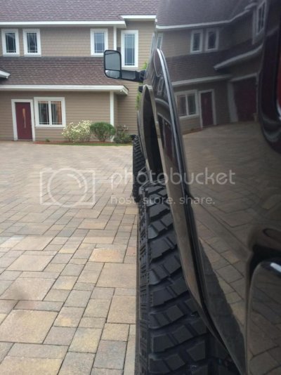

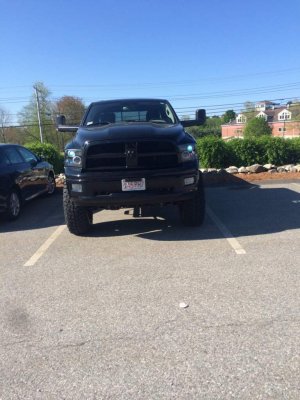

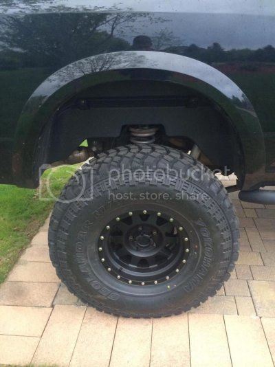

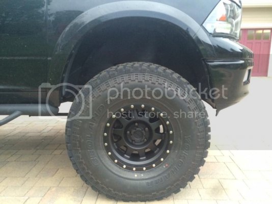

Got more pictures and some fender measurements
Front Driver 49.125"
Front Passenger 49.5"
Rear Driver 51.5"
Rear Passenger 52"

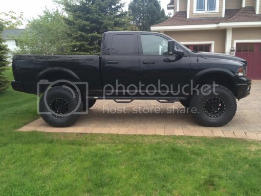

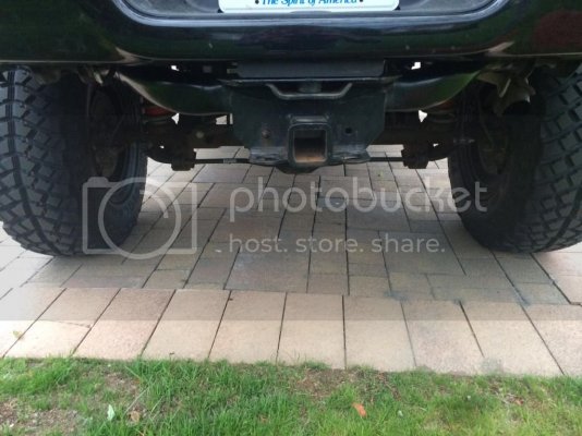

Trailer hitch after body lift:
Plenty of clearance in the rear:

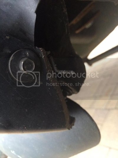

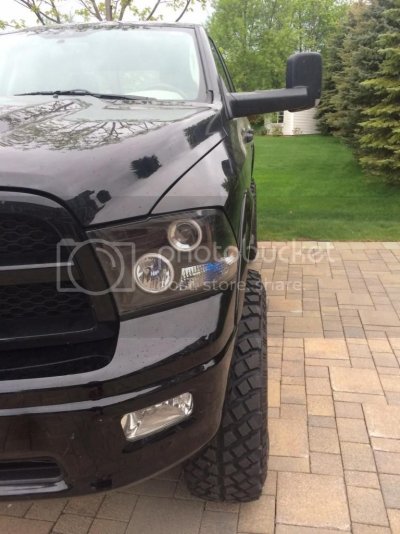

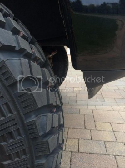

Had to do some trimming of the front air dam and then some of the fender flare, inner fender, and minor trimming of the pinch seam (The tires clear all suspension components fine):

Gas tank lean much? lol
Truck looks awesome. :waytogo:
rwalk
rwalk
Feb 28, 2013
541
47
Westford, MA
4.7L V8
Yes just a little bit hahah.. We ended up not cutting coil to compensate for it because of how the RCX coils are wrapped, so I may try to use 2 different size spacers or just leave it
