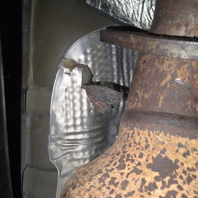

Hey fellas. Im back at it. Under the truck cleaning the crank case and oil pan gasket surface. Looking up at the passenger side by the exhaust i see what looks like a potentially torn ground? Am I wrong?
Hard to tell,but it sure looks like it's a bit worse for wear. I'd run a new one,as you can get universal ground straps at pretty well any auto parts store.
Good catch on the bad shielding bond cable.. Bad grounds and RF shielding bonds make the gremlins come out in full force and they are angry.
Man i cant seem to find where this sucker connects. Any ideas? Its on the passenger side where the exhaust manifold bolts to the rest of the exhaust system
Look on the back side of the head

I do see the two ground cable bolts that had the cable linking the two heads.
It might have the same style clip on both ends,and the other end could clip to the firewall,look for scratch marks on the firewall seam that should be fairly close to the heat shield
