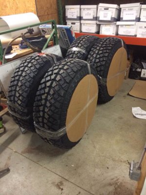

Some good news though, just ordered my 3" body lift w/ gap guards and 2" TGC rear spacer! And I picked up my new wheel/tire setup a few days ago!

I can't wait to see this! Still going with 40's?
Yes! Haven't taken the cardboard off the wheels yet because I don't want to scratch them while they're being moved around
