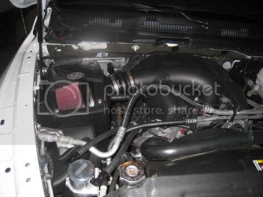

Just got my order from Moes! The S&B CAI came in today, and I had to install it! I am very satisfied. It has a nice growl like mentioned, and maybe it's just me, but there's a little more oomph. not much, but ever so slightly it seems. I am happy.
The hardest part of the install was the removal of the wheel cover, man those 3 plastic snap plugs sure are in there! Also, it was helpful to have a buddy help align & hold the intake tube to airbox and throttle body while tightening the clamps. Those rubber couplers are stubborn! The instructions, printed in color, were very good. Best I've seen as far as instructions.
The 87MM ported throttle body will be here Saturday. So that's next!

looks good. now try to keep your foot out of it to try to save some gas LOL
I use mine all the time lol

That looks awesome man, congrats!

Looks great!

Congrats ,wait to see when you instal the 87mm TB you ll be happier ,,

Very clean install. I like the catch can too. I'm looking forward to see what you think about the TB :popcorn:.

Exactly my experience--the wheel liner removal was a ******, the plastic tabs were a pain to remove. Once installed however the butt dyno says good mod!
