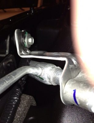

So I waited until the guys at S&B had test fit an intake on a 2013. Supposedly all good so I order one. Tonight I got my stock air box all tore out, PITA by the way because of the wheel well insert removal but I figure would be totally worth it. Get the new box put together and slide it in to find out that I cant attach it because the A/C lines are in the way!!!! I think, hmmm must be doing something wrong so I try repositioning, checking everything, and no matter what, there is no way this thing will fit and be in the proper position. I am so pissed that I took my truck apart only to find out S&B didn't do a very good job testing it. I am sure Matt will make it right but sooooo frustrating.
Anyone else have a problem yet?
A few pics to show you guys:

Update:
I got it on tonight but had to remove the brackets holding the A/C lines. I then was able to get the box installed but to reattach the larger bracket (see pic) I had to bend it to allow it to line up with the hole again. I think S&B needs to try installing on another 2013 and maybe design a new down tube to avoid the exreemly tight fit. I have installed many intakes in the past but this one was the biggest pain. Not only the A/C line issue but removal of the wheel well liner and getting it to line up again when reinstalling, especially with the factory flares. In the end I think the fit is just ok, seems a bit of a stretch from the TB to the inlet on the box and it is hard to get both rubber adapter to seat well at the same time. I do think however that this is one of the better made CAIs out there, better materials than the K&N. all of this is just my two cents, I know a lot of folks on here are big fans of the S&B and I hope I will be too after I get it out on the road. I am sure all of the trouble will be worth it when I open her up!

The A/C line is like that from the factory. It's possible that I had more trouble than others will, maybe my lines were positioned just differently enough to be a problem. I will be interested to hear others experiences as well. I provided this feedback to S&B, will keep you guys posted on what they say.

Just because I'm pedantic about information like this, but on mine the issue was atleast less severe as Recontango's.. while I had to undo mine to get it in, when I went to bolt it back up I only had to bend it downward and not cocked sideways like his. I also have enough clearance around the line to fit my fingers through.
