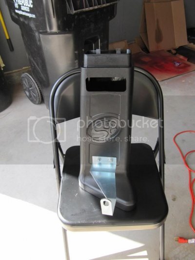

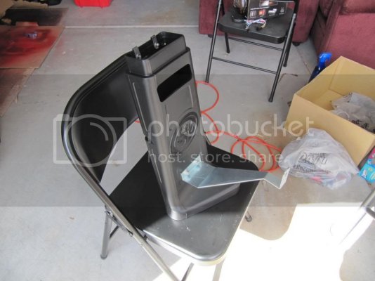

Ok wow...I guess this shows how disconnected from the forum I've been this year. I completely forgot to post up pictures of the intake scoop I finally got after a couple months of waiting and nagging. You'd think I'd remember after the next set of months I had to wait for the to finally produce a prototype bracket for me to test with tow hooks.
The pictures I have of the scoop are from the day I got it with the original bracket the scoop came with which is good if you are not running tow hooks. But for those of you, like me, that are running with tow hooks, S&B had to go back to the drawing board and redesign the bracket so that it can be equipped to both trucks with and without hooks. I unfortunately failed on taking pictures of the new redesigned bracket when I installed it and at the moment, I don't feel like crawling under my truck to snap pictures of it although I should because I need to take a look at my manifold bolts....
The install is very easy as long as you make one modification to the instructions because I honestly don't know what they were thinking when writing them. I did tell them my thoughts on it but as far as I know they didn't make any change. The thing I did different was I put the scoop in and loosely attach it's two bolts to the intake then I installed the bracket after it was up in the truck. You'll have a harder time trying to install the scoop if you attach the bracket to the scoop then try installing the scoop just because of the clearance issue's. It's especially harder if you have tow hooks. So for a simple install, install it in pieces.
And here's a few pictures

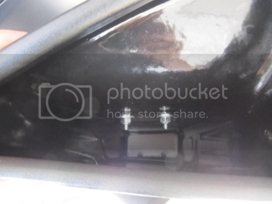

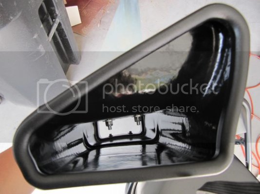

Just to kind of give you an idea of the size of the opening
And this is looking up the scoop after install

I have an S&B and what I notice is the aperture below the attachment point I guess that's an access to get at the bolts? Its where mine draws air now; reasonably low and definitely cooler than the upper engine bay.
So the Yettie foot is gonna make it better? Sign me up as baptized S&B, but skeptical.
