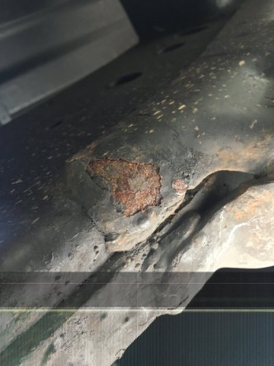

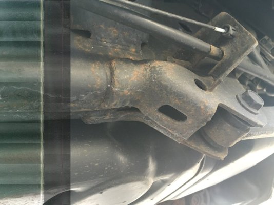

I went and got a cosmoline RP-342 undercoat job professionally done last fall, and this is how things are going... :sad72:
Did I do her a dis-service by getting this done? It was supposed to be a wax/grease coating that doesn't hold moisture like rubber coatings do yet here we are. It wasn't a spotless frame when it was painted but you can clearly see further development on the first photo after I picked off some of the flecking paint from the factory. The guy offered to do some touch-ups free of charge, but I'm hesitant on that offer as I'm thinking maybe I shouldn't have coated it in the first place?
It is my daily and I try to wash it weekly especially in winter (with undercarriage wash), and barely six months is quite disheartening. Does anyone have any advice for this situation?

Once the rust has started over coating it will not stop it, oil may soak in and slow it but nothing will stop it. Unless you remove all traces of rust and moisture and then seal it you will have a hard time controlling it.
With rust starting under the "factory" undercoating it would be very difficult ($$$$) to prep it for better protection.
If it hasn't started to rust and is dry when Cosmoline is applied it should stay rust free. I am surprised that your coating isn't more visible.
I'd be tempted to needle gun the existing rust and then recoat with a heavier coating.
My prefered method is Waxoly applied prior to any start of rusting.

The only thing that's going to stop the rust, is to completely sand blast the frame to remove rust that's already been started, I live in upstate Ny where they use Mag chloride and rock salt, those guys had no business rust proofing your frame over existing rust, I can't see any traces of their undercoating looks like it washed off by you doing a undercarriage spray wash, what condition is the rest of the truck in, wheel wells, rocker panels, door panels, welded seams?

The rest of the truck is actually pretty good, I was foolishly under the impression by the coating shop that using a neutralizing agent before application would prevent further development (A good mistake that was) which is why I'm so bummed about this as the frame would've been better off without all this.
Rockers are perfect, wheel wells save for the rear passenger are good, and the undercoating is still there it's that waxy matte black color, you can see the drip accumulation points on the bottom (not the weld **** beads). It is still very much there but the rust is developing underneath I can see it, that's what really worries me.

Looks to me your frequent washing washed most the undercoating off. The areas pictured are easy to take care of though. Wire wheel on a grinder, strip down the areas, then use a rust dissolver followed by something like rustoleum rust reformer. Prime and paint with a good enamel paint

I skipped a lot of this thread, but the area you show at the rear control arm mounts is extremely high wash and very exposed. Nothing is going to stay on there better than paint. Sand clean and paint this area often if it bothers you.
However, exposed areas like that are not what's going to get ya. Inside the rockers, doors, bed and frame. That's what will wreck a vehicle.

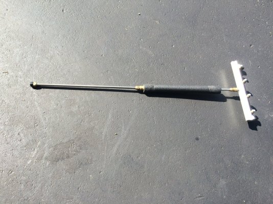

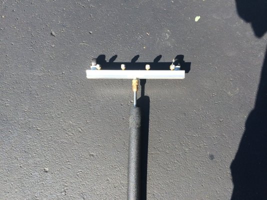

Every spring after the salt is washed off of the roads I wash the undercarriage of all our vehicles with the attached tool. Every couple of years I go to the local Krown dealer and get it applied. In between, I use Krown or Fluid Film spray for touch ups. On the trucks make sure you remove the tail lights and spray between the inner and outer panels of the box.
