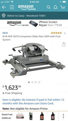

This is what I chose to go with since I chose a short bed as well as the Ram 5th Wheel prep package - which actually is pretty awesome!
Same one I have except for my year truck I just have one large "puck" in the middle of my bed. It's overall been a great product and I'm happy with it. I have had it stick a couple times and refuse to let my truck go when I open it. It's a somewhat known problem that I found several others have experienced as well. Basically, you just have to chock the wheels of the trailer and drive forward, and it will release. I don't like the stress it put on my landing gear as I yank at things, though. It's only happened twice and I may have contributed to it by leaving the hitch hanging from my king pin. I now support the hitch on jack stands to take the weight off the jaws and it's been fine. Overall, B/W are great and I'd buy one again in an instant. Great phone support also if you ever need it. I called and within a couple minutes I was on the phone with an engineer that knew every spring and bolt the thing was put together with.
