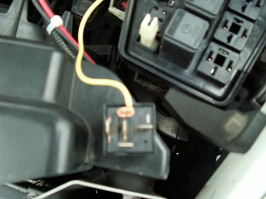

this will probably work with 4th gens as well..
in the 3rd gens, you had to jumper a relay in the fuse box and it would turn on the fogs whenever you turned the lights on...
Just add a jumper wire between the park lamp relay (pin 85) and fog lamp relay (pin 86)
