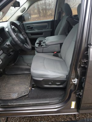

Awesome thanks! Just ordered cloth power seat from a 2015 SLT (part condition listed as "A") from LKQ for $277 shipped. Should be here Friday!

I just wanted to follow up for anyone that may come across this. @Ricks Ram is correct, the seat covers for express and Big Horn are interchangeable (the foam cushions are identical). I actually found it much easier to remove the cushions with the covers still attached and swap those between seats instead of trying to separate the covers from the cushions.
A big thank you to @DeereGuy as well for the great instructions and professional custom harness to add the power seat.
The end result is an Express Truck with a power seat that I paid a total of $240 installed (LKQ didn't work out, they changed there free shipping policy to region based). I'll make back quite a bit of that once I sell my manual seat. The adjustability of the power seat makes this truck so much more comfortable.
The only issue I have now is trying to separate the center jumpseat seat belt buckle from the old seat. It's on there really tight. I'll probably need to take it somewhere with power tools to get the nut loose.
