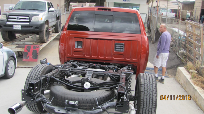

After a fairly tough Baja trip my tire was almost dragging on the ground. I bought a replacement winch and use a ratchet strap attached to the frame rails and run across the spare. This is bulletproof and takes the load off the winch.
