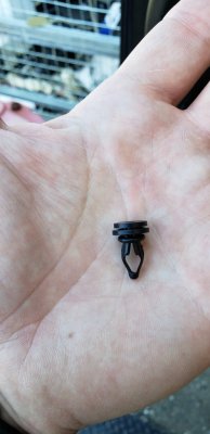

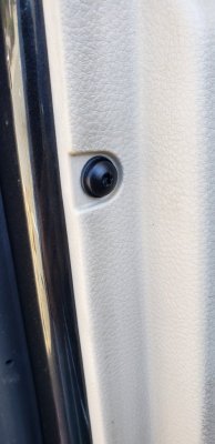

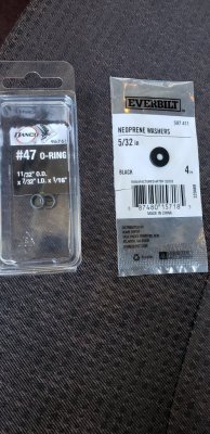

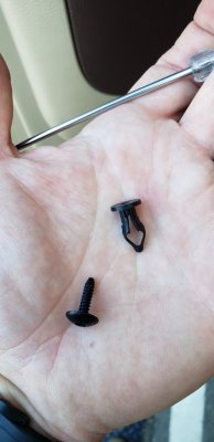

I just bought my 1st RAM 3500 a couple of days ago. I like the truck a lot, but every bump = shaking door panel. The door itself is secure, but the panel has a lot of play in it. I came up with a different solution to putting foam behind the panel. It seems to be working well. I popped out the plastic retaining clips and noticed that the holes in the door panel are much larger than the clips, hence all the movement. I stopped by home depot and bought some rubber o-rings and neoprene washers to take up that extra space (part #s in photo). I sandwiched the washer and o-ring together as seen in the picture and put the clips back in. The door is very secure and looks exactly like it originally did. The best part is that I did not need to remove the door panel...just the plastic fasteners.
