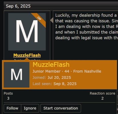

The OP wasn't here very long and hasn't been seen since last September.
