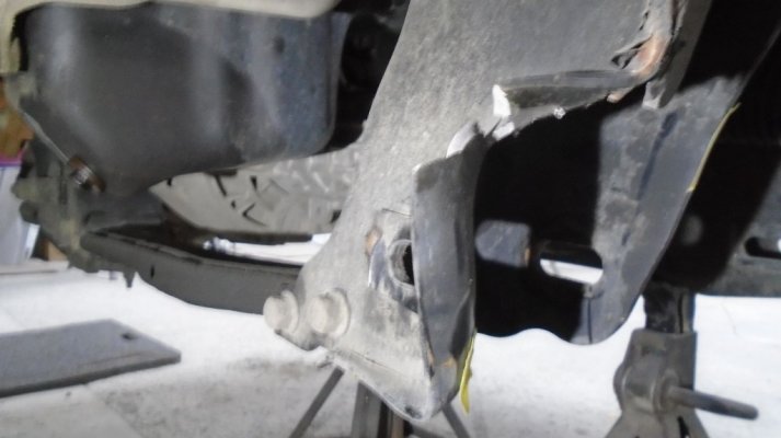

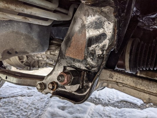

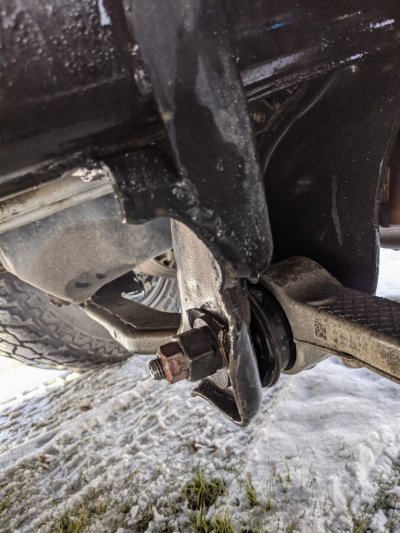

Just wanted to share the repair ICBC did to my 2017 Ram 1500 Laramie. ICBC wanted me to drive the truck 3 hours back to the shop they had do this hack job so they could reinspect their own work. They are now letting me get it inspected at a local shop of there choosing and then I get the privileged of driving it back 3 hours to the hack job shop for them to try to fix it again. Also no rental and I have to get my own hotel and meals.

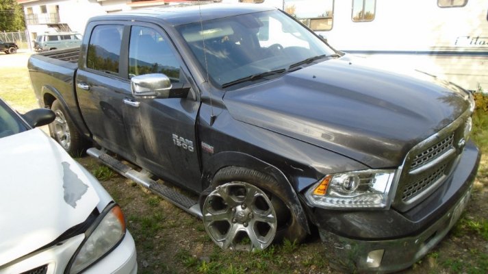

The truck doesn't drive straight and is pretty unpredictable when it hits bumps. I'm not too worried about myself, ill be fine unless its a semi coming the other way. I'm worried for the new family driving a early 2000s Toyota with there kids in the back who happens to be coming down the other way when this hack job fails. ICBC seem hell bent on just getting an alignment on the truck and calling it as good as new.

Just curious, what happened to cause that damage? Are those just mounting brackets for he bed?
D
Deleted member 26229
Guest

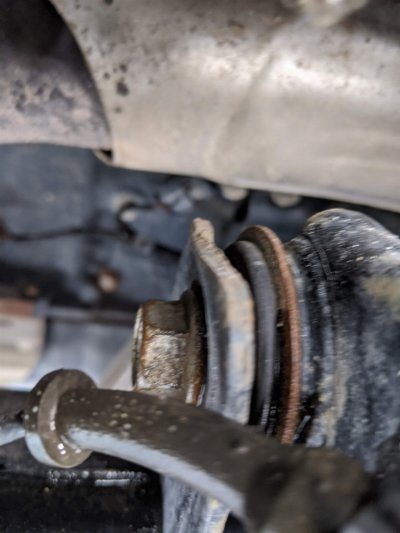

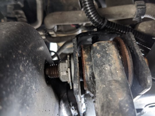

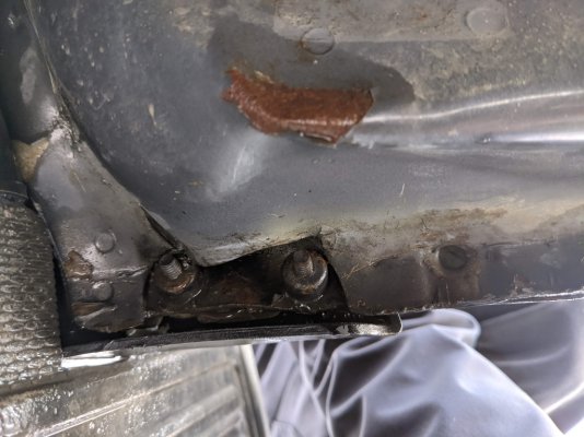

No sir, those are the front passenger side control arm mounts. When I say control arm mounts they are actually parts of the frame rail itself. The top picture was the original lower control arm mounting point. The entire front frame rail should have been sectioned and a new one butt welded in at the very least. But really the entire frame should have been replaced. If you look at the pictures you can see marking from where the shop heated and beat the frame mount point and MIG welded it back together. All other control arm mounting points are also bent which they didn't fix.

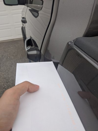

The pictures of the bed not aligning with the cab are simply to show that the cab was pushed two inches left from the accident. Really we should be using the wheel to cab for reference but this is hard to show on camera. So I show it by showing the alignment between the cab and bed (which isn't a big deal if it's off by a quarter inch).
The pictures of the dented rusted area is the inside of the rocker panel which wasn't fixed at all. Just hidden from sight be repairing the outside only.
