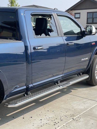

I went outside this morning to find this broken window. Like other comments, no evidence of projectile, glass was mostly on the rear passenger side, little on the rear driver side. Happened overnight or prior to noon, when I went outside. Temps from 45-75 degrees during this period. Doors were still locked. Note, glass was still in the window frame, looks like it broke from the center? I’ve had this truck about 6 weeks.

That sucks, My guess someone did that ! We been having issue up here on and off with kids going wild
