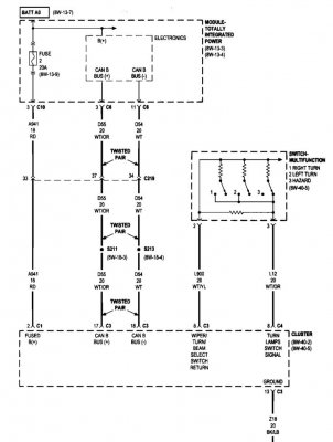

Made a huge mistake on my Cummins 6.7 2008 the other day when i was searching cause of my fast blinkers.
Got the bright idea to plusfeed the kabels in the multifunction lever to see which kabel goes to each side blinkers, happend to feed +/- and out goes the instrument cluster. ( think it was the third kabel from the left on the contact that goes in on the lever).
What could I've possibly destroyed? My vote goes for either the TIPM itself or just the cluster.

Hello,
I'd guess the cluster.
I'd also disconnect the battery for awhle just to see if have any effect.
Switch-Multifunction http://connectors.dcctools.com/details.htm?id=48437
