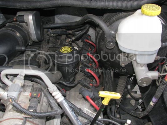

I havent had any issues with them in the past year or so. Adds a little color. Could only find one pic for some reason.
