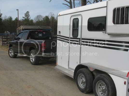

Similar on weight on the 05 I have, twin ramp load horse trailer with tac room. With both of them in there is 2K in weight between the 2 plus the trailer weight. We have towed in the mountains a few times with them and been ok.

True, the ATV in the bed is gonna add more strain that our similar load wont have to deal with. Very good point Cody, I honestly bliped over that part.
