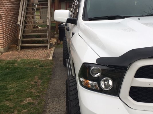

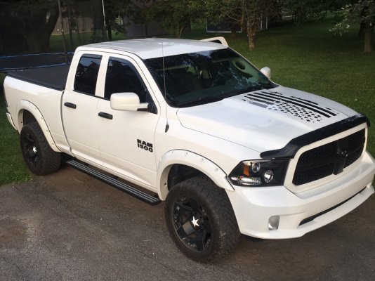

Robocop_9
Mar 4, 2017
406
224
West Virginia
These are 20x9 with 25 offset. They set out even with my flares.
SPEEDSTER00
SPEEDSTER00
Sep 10, 2017
46
9
Thanks Robocop. That's a -25 correct?
