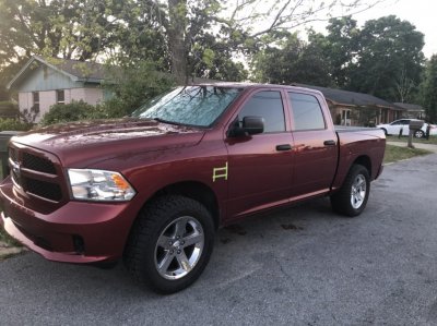

Tape around the old ones so u don’t have to pull out a measuring tape. Some heat (or do it on a hot day), dental floss and squirt some goo gone on them and let it sit for a few minutes and go to town. Then use either a plastic razor blade or your finger to peel the double sided tape off the car.

with the truck being new, just slightly heat up the badges and removed with fishing line in a sawing motion through the adhesive. The rest of the glue will easily come of with your fingers. If there is a slight outline left it actually makes it easier to get the new badges lined up

+1. I did this a couple weeks ago on my new 18 express and it was in the 40s here. Didn’t use heat, just fishing line. Then bug and tar remover to take off what adhesive was left that I couldn’t roll off the truck. Very quick and easy.
