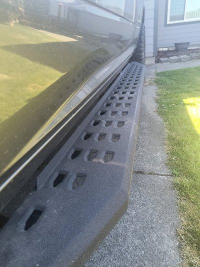

I have a set of LineX coated GoRhino RB20 running boards on my 2013.
They've been on for 8 years.
They've faded quite a bit, but still look pretty decent. As far as durability, the stuff seems indestructible.
Even the spot below the drivers door, where I step 5 days a week, twice a day, since 2017, doesn't show any wear whatsoever.
