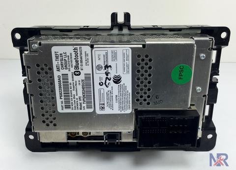

The back of my RA2 looks like this-
Compared to this-
I wonder why these are different....
