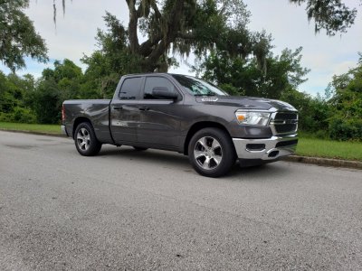

Drop is finished for now...
I used 2017 4x4 Struts off FB marketplace (40.00) up front for a 1/2" drop and 2" drop coils off Ebay (100.00)
It's not much but I didnt want to go real low on this one. The Belltech 2/4 kit I had on my 2016 was really harsh for a daily driver that gets 3-4k miles a month.
Ride should be pretty good since its factory up front.

I'm digging it! Looks good.
If I could do a GroundForce 2/4 drop, I would. But, the winters here dictate otherwise. I don't want to act as a plow during the winter when the roadways aren't freshly plowed. lol
I did a GroundForce 2" rear drop kit on my '16 Sport rcsb just to level it off.

Is your truck 2x4 or 4x4? I was considering putting the 4th gen 4x4 front struts on my 5th gen 4x4, expecting close to a 2" drop using the factory 5th gen springs. Sounds like it won't drop as much as I hoped. Lol

Link for the eBay rear springs?
