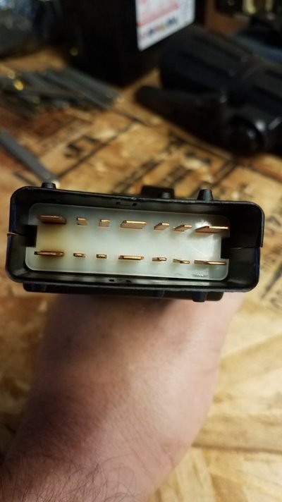

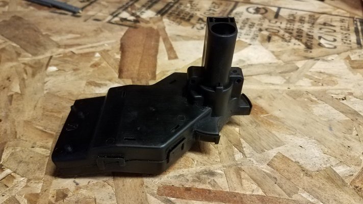

2002 dodge ram 1500 5.9L. When I shut off the engine the instrument cluster remains engaged for a few seconds and the guages slowly fade down to off, the alarm light comes on and there is a faint ticking like a watch. dome light and door locks do not work unless the ignition is on as well. If left for several days it will drain the battery. Radio not working at all. IOD fuse is good. Any suggestions? Maybe ignition switch?

Could be the ignition switch going bad. They are not hard to change. They are known for burning pins on them.
xtremewlr
Feb 12, 2015
809
355
Tucson, AZ
Agreed. And to clarify, he isn't talking about the lock part with the key but actually the other side. It's pretty inexpensive and easy to swap. I've done it on my 2004 because of burnt pins that would cause the HVAC blower fan to stay on after turning off the truck and killed 2 batteries on me.
