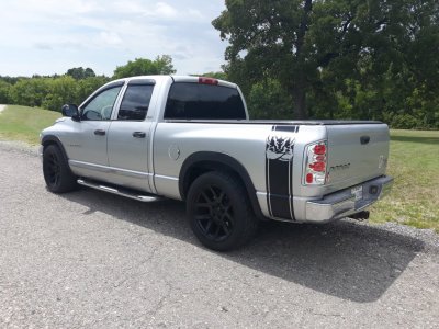

My 02 with the 5.9 & AT is having to rev higher to take off from a standing start. Normally on the street having to hit 2300 to 2700 rpm for it to launch. Also on level flat ground if I take my foot off the brake while in gear at a stop it does not attempt to move idling around 750 rpm. It was noticeable with the stock wheels and offroad tires before but it has gotten worse since upgrading to a OEM set of Viper SRT 10 Ram wheels.
I've upgraded most of the truck with looks and performance in mind but getting beat off the line by a import at a stoplight is not my idea of fun.20190823_135338.jpg
