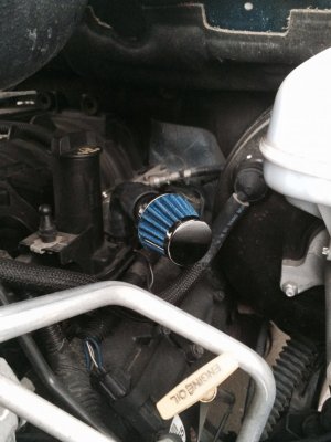

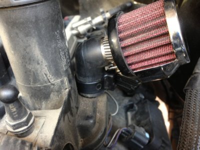

can i put a small filter on it or not what is the purpose thanks
done this on my both 06 and 10 , pictures of what i have done to the 2010

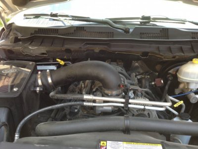

I did the same thing.

does any oil come out thru the filter?
SIhemi
Feb 16, 2014
1,424
680
Pennslvanvia
I haven't noticed any but I'll look again tomorrow.
