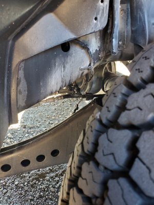

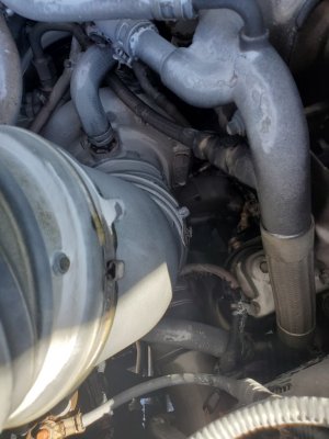

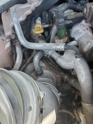

Here's one for you... 2019 limited, 6.7, 68 trans. 7k miles. Trans pressurized, blew out dip stick, sprayed on turbo and caught fire. Let's see what my warranty does now! 3-4 miles off road gravel road. 1400lbs 4 wheel camper towing a 2800lbs cj7. End of hunting trip! 20190920_113731.jpg 20190920_113724.jpg 20190920_113735.jpg 20190920_113737.jpg 20190920_113751.jpg

What was the transmission oil temp when this happened?
Everything was in the middle is all I recall. I was on paved road for about 20 miles @60mph. The took off on the gravel road about 4 miles, I guess, in 1st gear 10-15 mph (max). Started loosing power. Slowed to put in low lock figuring it must be struggling, looked all guages (all were ok/no trouble lights) because I thought I heard a transmission fan, when I stopped, put in low lock, looked up saw smoke. After the fire there were lights and check engine check trans check brakes check check check going on. At this point and all the looking into this, I think the new transmission has some kind of catastrophic failure. Created heat and pressure some how. Would love to know why. Nothing is built proff and even the best guys can make a defective part from time to time. **** happens. The space shuttle blew up! I'm glad fca doesnt make heart valves!
