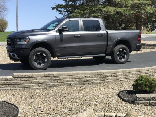

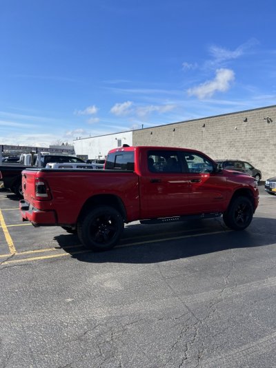

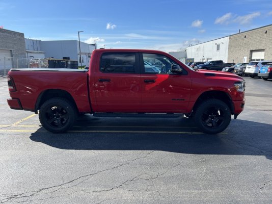

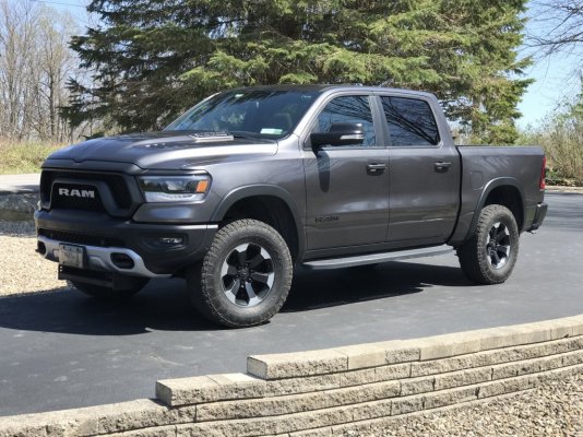

Did the Rough Country 3.5 kit on 2 trucks with great results .
